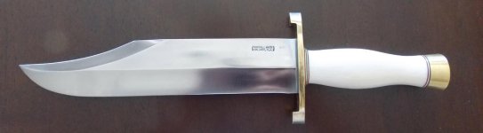

I have been shown a Randall Smithsonian Bowie. There are two things that bother me about the knife. It feels like the blade has never been sharpened. I can run my finger along the blade, and nothing. If I tried that with my other Randalls, there would be blood.

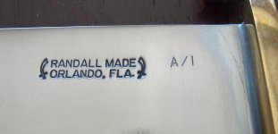

Also, there is a small "A/I or A/1 stamped next to the Randall Made on the left side of the blade. See the pictures. The knife seems to be similar to one I have, but my knife is still packed in a box in storage, and I can't get my hands on it to compare. I don't remember the A/I on any of my other Randalls.
There are people here who know more about Randall knives than I do. What is your opinion?
The A/I etched adjacent to the RMK trademark denotes a handle made of "Alternate Ivory". A/I, a synthetic material, is not offered by the RMK shop and must be supplied by the customer or dealer. The shop requires the "A/I" etching because this material looks too much like genuine ivory. Without the opportunity to view a cross cut (natural butt end) to look for Schreger lines, A/I is virtually indistinguishable from genuine ivory even for some experts.
A/I is an option that actually adds value to the knife.
Thanks. I really appreciate the information. To me, the handle didn't look or feel like real ivory. I knew it was some type of synthetic. Part of my misspent youth was being forced to learn to play a piano. The piano keys were real ivory, not the white plastic of today's pianos. I guess I did learn something. I can tell if something is ivory just by the feel to my finger tips. I am still a little puzzled about the blade. I guess the original owner wanted the knife for display only and did not require a sharpened edge. I think I will buy this knife.

David's link above will take you to Masecraft and a detailed description of A/I.

If you were looking for a detailed explanation about what Alternate Ivory is and how it came to be used in Randall Made Knives, they would probably refer you to Mr. Rick Bowles, who for the last 35 years is the only authorized Scrimshander for Randall Made Knives. He was selected for that position by Mr. Bo Randall himself. Mr. Bowles is the gentleman who introduced the material to Randall Made Knives and was the first to use it on a Randall Knife.
We are blessed here on smith-wessonforum.com to have Mr. Bowles to comment, help answer questions and provide a level of expertise not often found on guns forums.
You can request when ordering if you want the blade sharpened or not sharpened for display purposes . This request was not that uncommon with knives like the Smithsonian Bowie . If not specifically requested, I believe they were shipped sharpened.
I am pretty sure they will sharpen an unsharpened knife if you return it to them, but this info is several years old.
