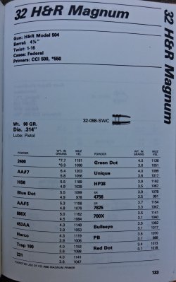

I am tempted to track down a used (only option) RCbS #1 Cast Bullet Reloading manual chiefly for more .32 H&R and maybe some .38 special cast data.
I have about ten manuals on the shelf now and untold number of the free booklets and the Hodgdon Annuals. The Lyman cast bullet manual skips over the .32 H&R 98 Grain Keith style SWC. That kind of blows my mind but no manual has everything, I am assuming that RCBS has this bullet covered as they sold that mold in their line up.
Can someone with the RCBS Cast Bullet Manual check for me? If not too much trouble posting a picture of that page if allowed would be awesome too. If it has what I think is valuable I’ll gladly spend the money on a used book. I am guarded buying books. Just bought the hardcover new Lyman manual and have found almost no good changes from three or four revisions back.

Thank you for looking that up. I am pretty sure my Arsenal mold is a direct copy of the RCBS one.

Look at all that data on one bullet. That’s fantastic! It looks like the bullet companies have nearly abandoned work on .32 H&R. Modern powders are real thin data wise in the chambering. I have Sport Pistol and BE86 that should work too. I have W231, AA5, 2400 on hand of those listed. I read that BE86 is rather close to Unique.
Interesting that their AA5 min is higher that what I saw on similar but not the same weighted cast lead bullets. I think most of my AA5 loads have been under the RCBS start charge. Accuracy wasn’t all that great either tha low.

Yes. The RCBS page is an exact duplicate of the pics from above.

The RCBS 98 SWC is not a true Keith bullet but is the most accurate bullet I have cast with in the 32's.
I see on the RCBs illustration that the wad cutter shelf is much smaller than my Arsenal mold.
I am not sure how much my accuracy with it is suffering, my Hornady seat/crimp die working the outer diameter of the front band. Granted my mold casts fat and that front band is sized in the .314 H&I lube die.
