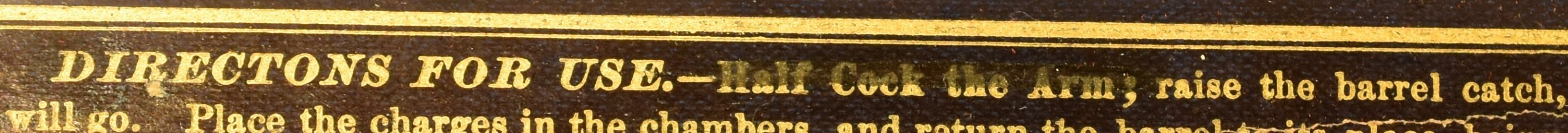

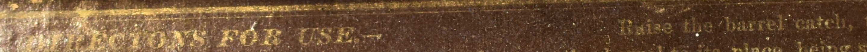

Hi There,
I was thinking about the 1-1/2's in the Factory wood case.
Edit: I added a pic of the instructions inside the lid of the case.
This one, one can see through the inked-out lines and see what
was printed originally
Cheers!
Webb

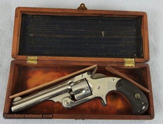

  • Smith-and-Wesson-Model-No-1-1-2-S-A-32-Centerfire-4-With-Box_101926825_59840_02466F61D9C73307.jpg
The first 100 or so had half-cock notches and the rebounding feature which proved to be irritating with the rebounding feature and were eliminated (sort of). The notch still exists on the hammer, but the notch has been "bridged" so that the trigger doesn't engage the notch. The die for the hammer forging has been 'nicked' which is a word used to indicate an alteration to the die rather than making a new one. In this case, the die was nicked to allow the edge of the half-cock notch to be filled so that the trigger skips over the half-cock on the way to the full cock.
Murph has a nice example of an early pasteboard box lid instructions with the "Rebounding lock" over stamp. The instructions say to carry the loaded arm with the hammer in the "safety catch". On later boxes, the 'rebounding lock, information was printed as the last line of the inner lid instructions and the reference to the safety catch eliminated.
Smith & Wesson made rather scarce wood boxes for these revolvers for the 3 1/2" barrel. Three-inch barrels have been found in these boxes. These wood boxes were the only boxes made at Smith & Wesson; all other boxes were subcontracted to outside vendors. The inner top labels were originally printed with the words "Half cock the arm". Frugal Smith & Wesson updated these already printed labels by overprinting a blackout over the words 'Half cock the arm'. The third printing eliminated the half cock the arm all together.

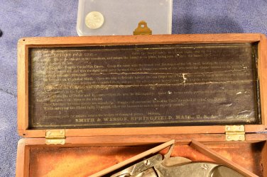

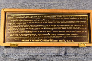

Hi There,
Case in point, see pics.
Cheers!
Webb
Hi There,
Cheers!
Webb
Thank you all for weighing in on this topic. Fascinating. And can you imagine a firearms maker today simply using grease marker or whiteout to correct printed instructions? The insurance people and the lawyers would have a fit. Times sure have changed. It's an interesting footnote in firearms history to see these photos of the box lid instructions.

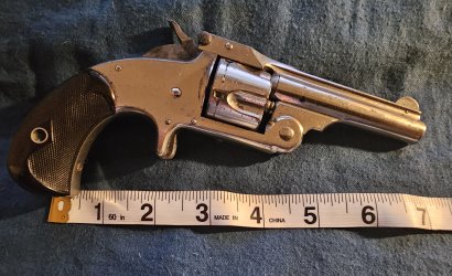

Hello all,
I just picked up this little beauty recently. The SN is 14099 which I think dates this to around 1880. When I first got home the cylinder did not line up exactly with the forcing cone when cocked. I consulted my LGS who brought the issue to my attention and blamed it on the cylinder gear teeth being too worn. Discouraged that I had just bought a "shelf rider" I went back home and did what I do with all new (to me) revolvers...gave it a nice long Ballistol bath. After a bit of soaking I wiped it down, tightened down all screws, took off the pristine hard rubber stocks, inspected the mainspring (tight and sturdy as a...well a brick sh**house). Just a light cleaning and like magic the timing issue was resolved! I am now looking for the best light load ammo to test fire it with. I am leaning towards Reed's .32 S&W Short 77g LRN (Original). Any thoughts, advice?
Hi There,
Nice looking example! Yours is toward the end of the 'plain' grips (before
moving to grips with block 'S&W' monograms). These are interesting to
collect because there were several engineering changes and changes to
markings.
I cannot advise you on ammo to use. I haven't shot mine. I put my reloading
energies into reloading for my Model #3's (and some of my rolling blocks).
Enjoy your new 'toy.'
Cheers!
Webb
