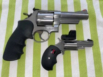

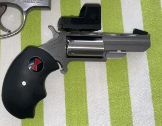

Red dot optic on a NAA .22 Magnum Widow-maker just because.
Simplicity rules.
AND your holster doesn't need to change!
CIMG9879 copy.webpIMG_8013NAA Black Widow & S&W .44 Mag  Guns &and Coffee  copy.webp
