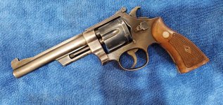

It would be nice to get the exact measurement of the barrel from the OP; 5.8" as stated in post #1 would make sense if the original 6" barrel was shortened to about the end of the original rib length.
I mentioned "5.8" because a certain "know it all" told me they were 5.8 back then exactly. I generally use rounded off numbers to explain a gun. I may say 6" in a quick description and not 6.5. My original point was being made as it wasnt a short desired barrel. Barrel is exactly 5.9975 with digital mitutoyo calipers. Cut for a pre war rod. I have two extras laying around. Both nickel. I may take brownells nickel stripper and put a pre war rod on it if the letter doesnt mention it. It was sent back twice. May of 52 and June of 60. Sight modification looks factory. No tool marks or anything. Id bet all modifications were done there.

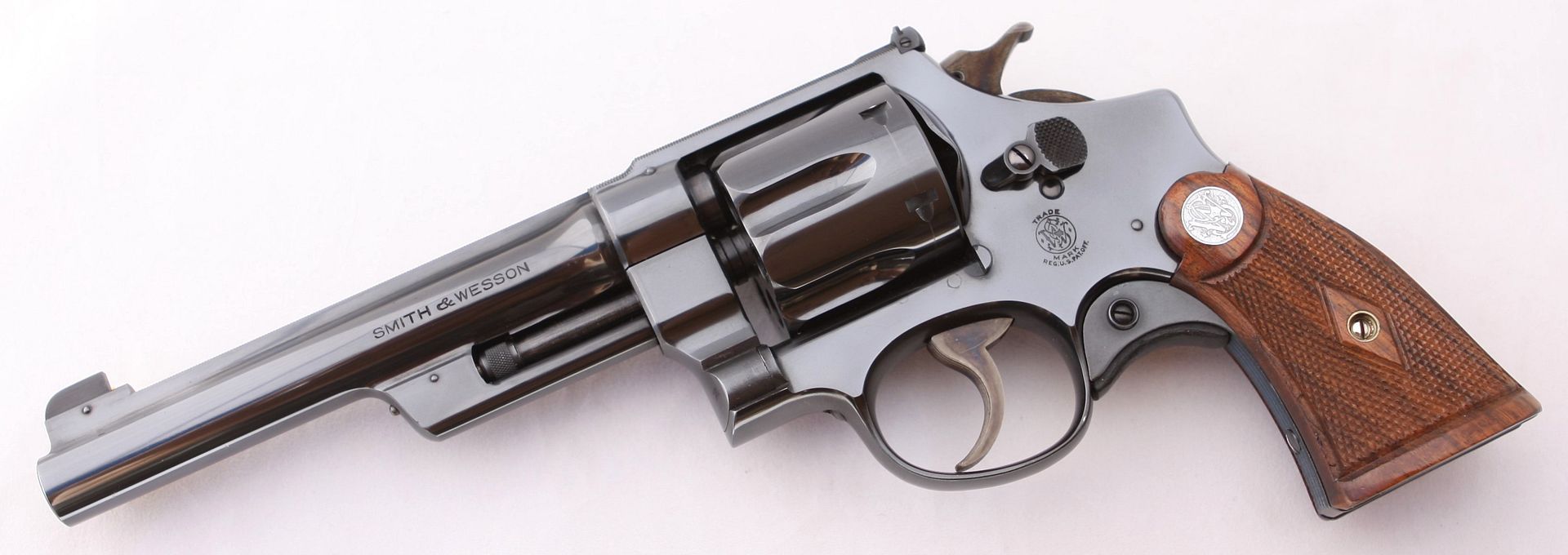

Comparison with OPs REG 4923 with REG 1530 (a 6"er in my collection)
... and for reference, this is the side profile of a King Reflector Ramp (from another RM):

First of all - CONGRATS!!! What a fun gun and for the money, it would be in my safe if I had come across it.:)
Consistent with comments above, my observations after looking at 100's and perhaps more than 1000 pre-war magnums:
1. Post war parts for sure include the rear sight, grips, and extractor rod.
2. The barrel appears to be a post war barrel as well- no large knob cut out (that I can see from the photo), post war large front ramp, and no rebated front sight (that I can see from the photo) i.e. the front of the sight base looks to be flush with the crown of the barrel (not rebated 1/16" - 1/8" like the pre-war front sight bases).

From the one photo that I see, that barrel does NOT have the cut out for the pre-war large knob. And the front sight ramp base is consistent with a Post War barrel (longer base) and most pre-war ramp bases were King bases. The pre-war Patridge sighted barrels typically had the square base, rather than a ramped base (unless it was a King ramped base). I see this as an early post war replacement barrel (some of which still have the Large knob cut out in the shroud). I would love to see photos of the shroud, and the frame with the grips off.
Terry:
The roll marks on that barrel are more consistent with pre-war roll marks, but not unknown on post war barrels (as noted by some of the ones that we have recently discussed). Roll marks are not even 100% consistent with the magnums of the same era, with slight variances front or back observed regularly.

I went back through the Historical Foundation stuff that we have digitized, and the only thing I could find for this gun is the original five pages of paperwork from when it was ordered. It was one of nine guns ordered, and the only Registered Magnum in the lot. As I mentioned before, it was ordered with a 6" barrel and a King red post ramp reflector up front and a King #112 bringing up the rear.
There's unfortunately nothing in our records about the factory repairs / rework that was done, but I know from having wandered through the records that the factory was called on to do all sorts of things, and they would generally oblige if people were willing to pay. That said, I'm not the expert on Registered Magnums and defer to some of the others here.
