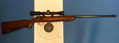

I love the Remington five teens. Among the .22 rifles on hand are Models 510, 511, and 512.
I just used a Model 510 last Saturday to take a pig snack. Was suppose to be duck hunting, but took an afternoon break for a hike.
The Model 510 here was made in September of 1946 and is worn and homely, but it sure is accurate.
