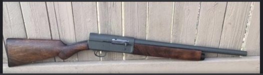

I bought a beater a while back for under 200 bones, sawed it off, and spray can parkerized it.
