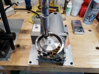

Commonly referred to as the Glock bulge (google it) due to the unsupported barrel. Most dies will not reach far enough down to eliminate that. I reload 9mm and 40 range brass but I rollsize all the brass including 10mm. This eliminates that issue all together. This is not a cheap tool but we shoot competition and go thru 500+ rounds a month. So it was essential for me to invest in it. Prior to with unknown range brass nothing but trouble as you have discovered.
