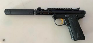

My Mk II Target, w/AAC Scarab is very accurate, and quiet. Running RWS subsonic required me to shoot it with my thumb on the bolt and work the action manually on every shot. Otherwise, FTE, FTF every time. I got a spring kit, don't remember who made it, and it runs perfectly now. If I need to eliminate the sound of bolt slap for real quiet operation I can use my thumb on the bolt.
