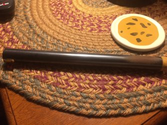

I’ve got a blued mag for a Ruger SR9 with a few pretty rusted areas on it I’d like to address. The areas of rust are raised above the metal. Was thinking of a vinegar bath but since bluing is a form of rust that’s probably not a plan. There is of course Evaporust but I’m sure that would cost more than a replacement mag, though I could of course reuse it on other things.
At this point I was thinking of boiling the mag body, carding off the rust and just using a little Oxpho Blue on the rusted areas. The only other repair option I see is just wire brush the areas and cold blue.
Thoughts?

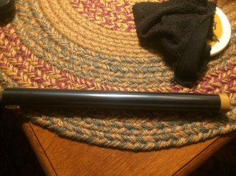

Thanks again for all the responses. I ended up using the penny trick to scape the rust spots then boiled the mag body in water for 20 minutes then swapped again and boiled for another 20. After that I went over it with 0000 steel, wiped it down with alcohol then applied Birchwood Casey Perma Blue as it’s what I had. A little oil wipe down and it looks decent.
