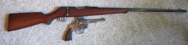

Lee gave up a nice one. I had to get a companion gun for my 32 WCF without giving up my first born so I went with this Savage 23C from the same time frame (early 20's).
