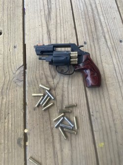

I just picked up a used but like new 351pd 22 magnum and it's shooting about 4 to 5 inches low at 20 ft. I'm shooting Federal classic 22 mag ammo.
I did call Smith & Wesson and they said they'd be happy to send me a label and fix the gun ...before I do that, thought I'd get some comments about possibility it's ammo related. Also, before I spend a ton of money on different brands of ammo I thought I'd get an opinion here.
I appreciate the knowledge on this forum.
4-5 inches low at 20 feet may well be your trigger press rather than sights. Has someone else shot it? Have you shot it with the gun supported? Or, wonder if the original owner "improved it"?
My experience is the S&W .22 caliber revolvers are very picky, gun to gun, on what ammo they like. I tested eight loads in my 351PD. It was factory new, but had lots of sharp machining and had a rough trigger pull.
In my 351PD, it really liked a Browning labeled and CCI round, shooting to POA. About four loads were in the vicinity of POA, within an inch at 15 yards. A few loads were absolutely a disaster.
I would suggest testing a variety loads to ascertain the best load in your gun.

Im no expert marksman, but I doubt being 5" low at 20' with a ransom rest is ammo related. Experiment with different factory ammo to be sure. Me thinks your front or rear sights need adjustment.
Might try CCI Gold Dot, or Federal Punch. They are a little hotter and might raise the POI. The range of 20 feet is pretty close for sighting but I understand why. You might also try some other stocks, they could make a difference. Even your hold makes a difference in a gun that light.

OP, it's amazing how many responses you get that don't address the issue.
The gun is in a ransom rest!
The real answer is no. At 20 ft the ammo will not cause a 5 inch difference. I have never seen a 5 inch discrepancy at 25 yards.
Some people just can't process the fact that Smith and Wesson turns out junk; at least occasionally. My personal experience is 66% junk. (New stuff) Your experience may be totally different. If it is, I'm envious.
It's shooting low. Give the guy a little credit. I have 4 S&W 45 autos. Two shoot 6 inches high, one shoots 2 inches low, one shoots 4 inches to the left. The one that shoots left, you're thinking "no big deal, just drift the rear sight to the right a bit". Great theory, but S&W must have used a 50 ton hydraulic press to mash those sight into the dovetail. They may as well been welded. That rear sight isn't going to budge, and I have a sight pusher tool.
My advice from experience: NEVER buy a fixed sight anything unless you plan on just pointing the thing.
