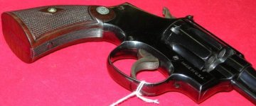

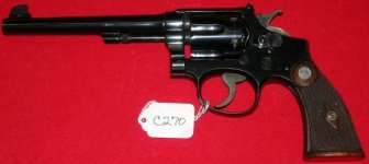

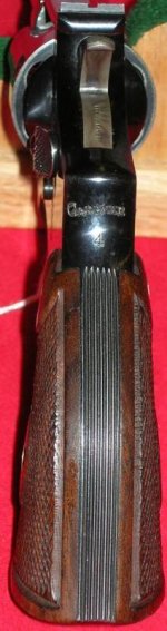

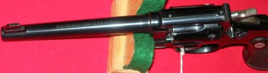

S&W .38 HE 5th Target (?) Model...Is this a standard HE or does it have extras? Grooved grip straps, target style sights, etc.? Thanks for looking. Ed [email protected]

ED, the gun looks OK to me but it does have a factory rework star on the butt. If you pull the stocks, there should be a date coded on the frame. Something like 6 45, which would stand for June 1945. No telling what she went back for, could be finish or could be parts. Nice looking old S&W. I'm not familiar with a .38 HE 5th model, someone else will have to chime in.

There isn't any such thing as a 5th Model K frame. It's a .38 Hand Ejector Model of 1905 fourth change. Production would have been late pre-WW2 (probably 1939-1940 timeframe).
Grooved grip straps became standard on K target frames in 1923.
You ask if it's standard or if it's special? It's a standard target model. Target models are much less common than the service version Military & Police model, but aren't quite in the 'rare' catagory. They are worth more than their fixed sight conterparts, though.
Beautiful gun, by the way! I have two early target .38s. A 1905 made in 1905 and a 1905-first change made around 1910.
Sam;
As discussed earlier, this is a prewar M & P Target 4th change. I don't believe there is a 5th change, unless the postwar short action was called this. Its serial number puts its production in the early 1930s. Agree about the star marking from the previous poster, but I doubt the reason is findable even from the factory records. Nice gun!
Appears to be a K38 Target 1st Model. (or maybe that's 1st Model Target) I want to say Outdoorsman but that may pertain to the K22 1st Model. If either of you can get it for $600, judging by what I can see it's not unreasonably priced.
