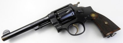

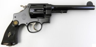

The British broad arrow (also called the "crows foot") was the standard military acceptance stamp. If you see 2 of them point to point (see picture) it means sold out of service. You'll note the "C" enclosing the broad arrow which was the Canadian acceptance stamp.

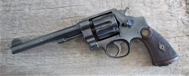

The stamps are a little different on the side, the Canada stamp is on the butt, Australia 2nd military district stamp on back strap, the 2MD covered most of New South Wales and was headquartered in Sydney.
Serial number on the cylinder face and small gap when closed indicate it has not been converted, this one has not.
Good luck, big fun guns! :D

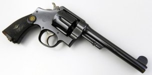

This one's stamped with the plain broad arrows point to point indicating deaccession. It also bears the crown over 30 marking.

As you can see, the 455 caliber has been eliminated from the barrel of my revolver, in fact Wesson's N is thinner, instead of the N there are reverse arrows.
The revolver is still chambered for the 455 Eley, the cylinder has not been touched.
Definitely reblued
At this point I dont understand what life this revolver has had and why was the caliber cancelled?

Many of the earlier .455 BSRs were not marked with the caliber. The serial # will help us determine if it was or not.
Is really evident that the Smith & Wesson lettering on the barrel lags far behind photos of the letterings of other revolvers, but it is also evident that the letter N is not stamped as deeply as the other letters, it looks like the area has been subjected to an abrasive brushing.
However, there could be that the marking of the 455 caliber had not been done.
The serial Number is 24161
Marcella,
See my research thread here, post #1: .455 British Svc Revolver Research Thread
You can see which serial # groups had the cal rollmarked on the barrel and which did not. If you look at category 3, the 455 2nd models, your # 24161 is in the range where there was no caliber marking on the barrel.
However, you will also see some exceptions! Yours may be like one of those. This typically means those exceptions are exceptions because they were shipped later in a batch of higher numbered guns when the cal was marked on the barrel. Later than the serial # would indicate.
So you could very well be right about yours having the cal removed. It's very difficult to completely remove markings so close to other marks like the N in S&W w/o leaving a ledge or groove where the mark was removed.
We do see some unevenly stamped roll marks from the factory from time to time. And the slash marks on your barrel where the caliber should be marked are strange. Why cross out something that was removed? Perhaps the .455 was removed after the slash marks were made but the slash marks were so much deeper than the .455 stamp, they could not be completely removed?
Also since you gun has not been converted from the original cartridge, why would the cal mark be removed?
Very strange.
Could we get a photo of the rear surface of the opened cylinder? I'd like to see if the chamber mouths have been recessed.
