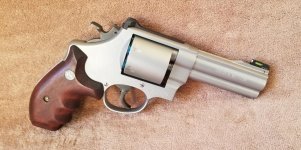

I have pretty much owned and qualified with every 625 made prior to the lock. The only one I still have is this 625-4 with Performance Center parts and tuning.
