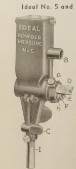

Reloading Smokeless powder
I've studied reloading equipment in depth and the simple truth is there was no reloading equipment commercially made specifically for smokeless powder pistol loads until the 1920's!
Anyone who attempted to load smokeless prior to that time for pistols was " Asking for it"! Oh sure, I've found loads listed but where are the tools?
Smith & Wesson reloading tools made until 1912 carried black powder scoops only!
Ideal field loaders " Always" carried only black powder scoops until 1916 when Marlin stopped making them!
All early iron powder measures were for black powder only!
The earliest powder scale for reloaders was commercially available in 1923!
You "must have" a loading data chart for any fixed scoops or powder measures in order to safely load smokeless powder! Early smokeless powder was DuPont, Kings, Bullseye. All were different density which means you can't use the same scoop!
Fixed bench mounted powder measures must also have a micro measure device to adjust for the specific Smokeless powder being used or you will not be able to measure the various density loads accurately or safely!
See photos. All Ideal scoops until the 1920's were black powder only!
I have documented target loads as early as 1904 using Bullseye powder but I have no idea what bullseye powders explosive content rating or burn rate was in 1904. Nor do I have a clue how they safely measured the powder by weight? They must have used a pharmacist drug scale? Who knows?
If someone knows of a Pre-1920 "smokeless powder " measure? I'd sure like to see one! Clue me in cuz I sure can't find one! Ideal catalogs in the late 1930's were still selling black powder measures and recommended the micro scale to adjust for smokeless loads.
This research basically means that the vast majority of pistol shooters prior to the 1920's were buying factory loaded smokeless boxed rounds! Which was readily available.
With all the research in early reloading? I honestly believe folks were blowing up pistols because they didn't know they were loading smokeless to begin with. Powder was powder before smokeless. Oh sure F or FF or FFF etc but you could get away with being ignorant with black. NO WAY with smokeless!
Note: 20-40% of the U.S. population in 1900 couldn't read or write! I wonder what percentage could comprehend loading data well enough to load smokeless safely back then?
