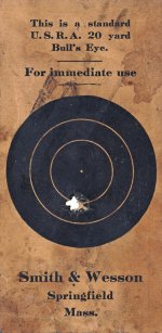

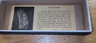

Thanks, those are helpful :) What pearl stocks sticker? And what is that target thing in the bottom of the box?
The factory was providing quality pearl stocks throughout the 1800s up to around the mid-1890s, when large distributors started replacing hard rubber stocks with their own inferior grade pearls. Factory would get the complaints about those distributors stocks because the buyer did not know they were not factory installed. Around 1898, the company started placing gold medallions in their pearl and ivory stocks to differentiate from the distributors and placed a label on the bottom inside of the box.
S&W used to provide a target with a shot placed in the small bullseye to show the buyer that the gun functions and shoots where aimed.

    65 KB

I do have pearl grips, but being that mine was made in 1897, before the medallion, how can I tell if they are factory original?
Also, was the target provided in all of them?
Best way is factory letter that will tell you exactly where and when the gun was shipped. It will also tell you the gun's configuration. Another method is to compare the thickness of the stocks with factory hard rubber and they should be the same. I have a 38 Safety with hard rubber stocks and they measure 1.1" wide installed on the gun. I also have a non-factory set of pearls that measure .94" installed on the gun.
Targets were used for some time around 1900, but not sure when they started or stopped using them.
