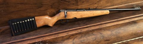

I inherited a 325 C from my grandmother and picked up a couple extra magazines while they were still available without breaking the bank. Good solid little rifle that I shot recently for the first time in about 20 years. I also picked up the lower side mount many moons ago but never got around to drilling and tapping it. Looks like now I won't.

Reading this post, I went and looked in my "Purchased but Never Fired" stash and discovered I have a Savage / Springfield Model 840 Series E .30/30 Rifle. (Model 340 or 840 ? lighting is dim). I think ? the wood is light colored.
The "Springfield" is indeed a model 840. Same gun.
