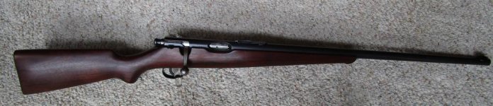

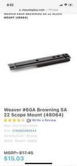

I have 23c 32-20 I acquired about a year ago. It came with a box of 100gr Remington express ammo, which wouldn't hold a shotgun pattern. It's quite accurate with both cast and jacketed bullets. I did mount a 4x weaver on it by making a slight modification to a weaver scope mount. A weaver mount for a browning sa-22 needs one of the mounting holes opened to take a 10-32 machine screw. Good luck finding a load and enjoy.

I have 23c 32-20 I acquired about a year ago. It came with a box of 100gr Remington express ammo, which wouldn't hold a shotgun pattern. It's quite accurate with both cast and jacketed bullets. I did mount a 4x weaver on it by making a slight modification to a weaver scope mount. A weaver mount for a browning bsa needs one of the mounting holes opened to take a 10-32 machine screw. Good luck finding a load and enjoy.
I'd like to try the same mount. What is a Browning BSA?
