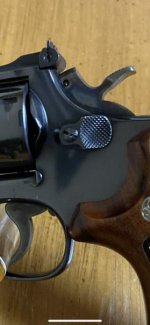

Is the hammer and trigger on the 19-3 considered target trigger and target hammer?
Target Hammer, Target Trigger?
Would this be the Target hammer and Target trigger? Might be hard to tell by these pictures?
