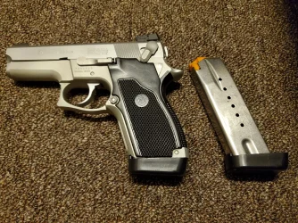

Hey guys - would a model 59 threaded barrel fit a compact 2nd gen pistol (469 or 669)? I imagine it would stick out a bit. But would it function?

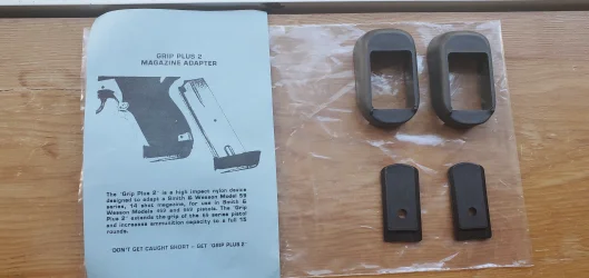

How about the mags? Would those also work with them extending out the bottom?
Just looking for a new project and want to make the most of the parts I got.

The model 59 barrel will "fit" into a model 469/669 and will stick out the front of the slide...
But it will also flop around like a mackerel because the 469/669 utilized a "fixed" barrel bushing designed for a "belled" muzzle on the barrel whereas the 59 barrel used a removable bushing and the barrel has a consistent diameter for its length.
The mags will work.
