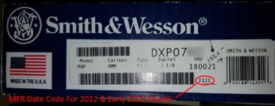

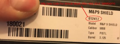

RobzGuns US Veteran Joined May 10, 2012 Messages 2,907 Reaction score 2,390 City & State/Province Texas Mar 26, 2017 #2 Do you have the box? The build date is on the label. Early Shields have a 4-Digit Build Code. Later Shields have a 6-Digit MMDDYY Build code. If you bought used and don't have the box, email the Serial number to S&W CS and they will tell you. Attachments EarlyShieldDate.jpg 195.6 KB LateShieldDate.JPG 187.1 KB
