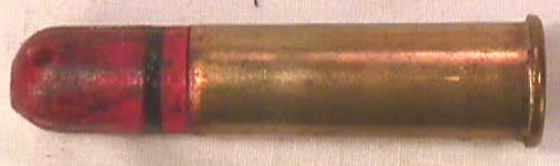

Texas Star, long long ago they made 44/40 shot loads. That was the father of the 410. So some of the older 410s were marked as 410/44, so that you knew you could use the 44/40 Long shot loads, that were still on the market.
Alpo-
Wow! Thanks! :) I've wondered about that ever since I got that gun from my grandfather when I was six!
No one I asked ever knew, including gunsmiths. (I have come to realize that many "gunsmiths" are unworthy of the name.)
