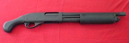

Yes, for example the "Serbu Shorty" - see
Super Shorty
I've always wanted one of those...no real or even rational reason why, just wanted to own one, especially now that they also make them in 20 ga. According to my LGS, the sheriff in my county will sign off on them, so I could actually get one. The only thing really stopping me at this point is do I really want to pay $700 or so for a shotgun that I will very likely never shoot...or very seldom, anyway. But then, I have one heck of a lot more than that invested in a motorcycle that I never ride either.
