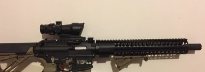

Here is a couple of pics of my SBBR, UK Legal 12.5inch barrel.
Claymore Muzzle from Troy.
Other than some re-zeroing after stripping it down this last week or so to swap out the hand guard, runs sweet as a nut.
eats all and anything it is fed, doesn't complain and ALWAYS make me smile when I mag dump.:p
Local Range has just got some steel up, so next chance I get, Sound Mod on and see them greys frown when i swiftly dump 50rds with no noise other than... ting ting ting ting ting :D:D:D:D:D:D:D:D:D:D:D:D:D:D:D:D:D:D:D:D:D:D:D:D:D:D
