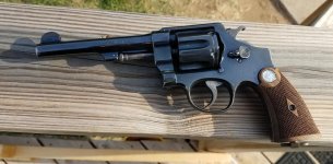

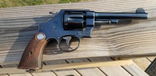

Hello. Today I was inherited a smith and Wesson model 1917 I think.

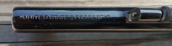

It is property marked under the barrel. Has U.S. marking on butt. Serial matches on butt, barrel and cylinder. It has flaming bomb proof on upper left of frame by top. Has various eagle number proofs.
Grips were changed to the SILE ones on it and have to try and find a set or a decent set of repops.
My question is based on serial number 80956 which matches throughout so far. And the various markings. I'm confused on it having the logo on right side plate which I haven't pulled yet and the made in USA marking on bottom right front of frame what it is I have here.
Is it a post war put together? Any help would be greatly appreciated.

I see that as being built in July of 1918. To the best of my knowledge the S&W logo should not be there as it “should be” a civilian model. Some more versed in 1917 will be along to help your confusion!
Kevin
That's what has me confused and the style of made in USA and address on side of frame. But then it has all other markings it should have if it were a ww1 army issue. Thinking it's one of the later left over build or ???

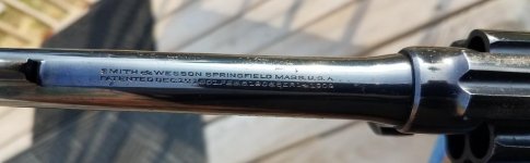

Can you post us a close up of the lower front, right-side Frame Texts?
I think the S&W logo and the trademarks were applied when the gun was sent back for repairs/refinish in the 1970's. Roy Jinks was able to stop these additional markings which were not original to the gun. If my time frame is off, someone with a lot more knowledge will be along soon.
Nice inheritance! I think you'll love it.
Charlie and Mike both nailed it!
In addition, when it went back to the factory, it got a barrel change in the Service Dept, indicated by the S and <> stamped on the bottom of the barrel.
Look for that factory rework date on the left side of the grip frame by the 'toe'.
I pulled the grips and the sides on back strap have small pitting Mark's that have obscured the number. I cannot make it out. By the bottom pin the fits into grip to stabilize it from shifting there is a small stamped number but I cannot make it out. If this was sent back to smith and wesson and received repair/rebuild and including a rebarrel. Did it go back into service or inventory seeing barrel is property marked. From the blue loss on grip back strap and pitting from water or sweat from hand that got under grip panels it would appear it saw some use after being redone.
Is there a way to narrow down the date depending on the updated frame text when they switched to that style with more then just made in usa.
The change from one to four line stampings on the right forward frame was in the later 1940s. The marking of refinished guns with the large logo and four line stamping was in the mid-1970s.
If you look on the side of the left lower grip frame the small numbers may be one or two digits, then a dot followed by two other digits, the first probably a 7. Refinished guns may also have R-S (refinish-standard blue) in a rectangle stamped there.
The property mark on the barrel is a bit of a mystery, as I suspect S & W no longer had surplus 1917 Army barrels by the 1970s. Perhaps it had a barrel swap at a much earlier date followed by the later refinish, but that is pure speculation.
Let's sum it up, based on what has been deduced:
This is a WW I issued 1917. After the war, it passed into civilian hands. It went back to S&W, where it received a new barrel and a stamp on the lower right side of the frame. It was repaired/refinished.
You have received a wonderful gift.
It is not a certainty that it was rebarreled. Barrels are pulled from the frame when a gun is refinished and blued separate from the frame. It would have been marked so that it would be returned to the Service Dept. That could be the original barrel. The font of the numbers is correct for the original barrel, but not for the 70s when this gun was refinished.
