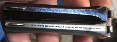

I had forgotten that I actually have spare parts for the Model 1’s. You can plainly see that you can not swap barrels between the 2nd and 3rd issue 22cal. The width difference at both the base and overall height with totally different latch and catch would require significant machining! This fact also strongly supports that the Mongrel .22 cal is real! See photos.
    33.3 KB
    33.3 KB
    62.3 KB
This photo says it all.
    83.6 KB
So the barrels will not interchange between frames. So it can’t be a put together! The concept of the frame being faked is kinda ridiculous I think. The time and effort to “make” or manufacture an “Iron frame”? Zero profit! Unless they were made on contract with another firm? I don’t know. That would still constitute ligetimacy or an authentic variation or issue.

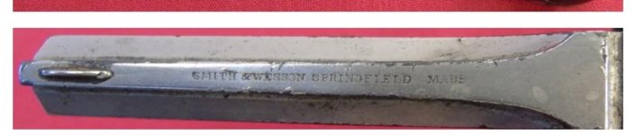

Please post a picture of the stamping on the top rib of the barrel when you get the gun. I think we need to rule out the possibility of a patent infringement gun.
Last photo available for now
Sorry I didn’t post this before. This is from the auction. The address is correct. Gotta pack for the show. I will advise further soon. Thanks for everyone’s interest.
    18.5 KB

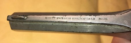

Your address is different from my two examples. Both mine, 70xxx AND 75xxx look like the text below. Subtle difference, but why is it different??
SMITH & WESSON.SPRINGFIELD.MASS.
What is interesting is that the Model 2 Revolver also had the single line address with the dots where spaces should be, but a slightly larger with an extra dot.
SMITH.& WESSON.SPRINGFIELD.MASS.
I helped a couple authors ( Robert Jordan and Darrow Watt) with research for the Pocket 49 & Baby Dragoon about 18 years ago? The research proved that the Colt Factory changed dies ( machined stamps) in lieu of them wearing out. They would normally last for about 25,000 stamps but as you follow the increase in serial numbers you will actually witness the die breaking down. Broken letters or missing parts of lettering, dots and dashes etc. This would be the same with Smith & Wesson’s I would imagine. Notice also that the die stamp on the Mongrel seems to match my parts barrel stamp. I will photo them side by side when I receive the Mongrel. This suggests that the parts barrel is a later serial numbered 2nd issue.
