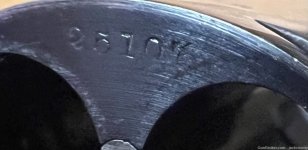

Fast turnaround on the Smith & Wesson letter. Interesting that the letter states the revolver was originally shipped in caliber .38 S&W Special and U.S. Service cartridge (.38 Long Colt). Here's a closeup of the cylinder of a similar 1902 USN revolver shipped to the Brooklyn Navy Yard on 20 January 1903; cylinders look the same to me (unless my old eyes deceive me). See details here 2019 Jack the Dog auction.

After checking other resources, it seems that Don might not be correct, since it is listed as a 38 Long Colt for the Model 1902 Navy in Jinks book. The Model 1899 Army and Navy revolvers also were shipped only in 38 Long Colt and stamped "38 MIL". What caliber is stamped on the barrel.
Just a moment...
Your letter is incorrect. The 1902 Navy guns will not chamber 38 Special unless they have been reamed. Look at the auction you linked to again. Note that Jack states: "The chambers have not been reamed out for .38 Special and it remains original."
You should ask Don to redo the letter.

I would guess that maybe the majority of sellers out there do not even know the difference. I have seen some converted Army and Navy guns here on the Forum and other places that make no mention of the chambers being bored out. There have been threads about these early military 38s here and even some members were surprised to know that their guns were altered. I would suspect that a converted gun has lost some value, but not sure how much?
