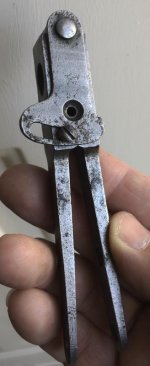

I’ve always wanted one of these molds. It’s seen in the N&J book however it is listed only as a 44 cal mold. What bothered me about the mold is the Pre-1887 bullet design? I mean it looks like a 44WCF to me. Especially during that early period. These early molds were replaced with the improved kit in and about 1887 that incorporated the peanut handle double cavity mold.
After examining this mold I’m both astonished and amazed that it actually is a 44 Russian bullet mold. Notice in the photo the 44WCF case head does not fit in the machined primer boss. I tried earlier non head stamped rounds also and they also were too big!However The 44 Russian, special and magnum heads fit perfectly flush. This is required for this type of mold in order to replace the spent primer!
The proof positive is the Actual bullet diameter mic’s at .429 which is correct for the 44 Russian and wrong for the 44 Winchester. (.427)
Anyway, just some rock solid evidence that Smith & Wesson incorporated a flat nosed bullet for the 44 Russian early on as an option for the reloader. To me that’s beyond amazing! Still I wonder why? Did they know the flat nose provided better stopping power?

Who made the mold?
That’s the real question isn’t it? Who made the mold?
We know these type molds were in early Smith & Wesson reloading kits from about 1876-1887.
Remington had identical kits during the same time frame with identical molds. Unique only to their specific calibers but that Remington also sold kits having Smith & Wesson calibers!
Most collectors believe there was actually a bullet mold maker that was contracted to make them. I agree with this position. Nobody seems to know who it was but the very unique pattern can be traced back to the Civil War. So the mold maker was obviously well established and remained in business for a long time.
This particular mold is off the hook! It makes no sense by that I mean the flat point design? I can’t find a 44 Russian in any of my books or in my collection with this design bullet. They are ALL round nose. Even the early target bullets were round nose throughout production so I have no clue where this mold fits. In fact there is another mold of this exact type pattern that has the typical 44 Russian round nose conical design. I can also claim from research that these molds were obsolete prior to 1890. So it’s hard for me personally to believe they kept making them after that time because “ Heat insulated” handles were a vast improvement on these “burn your fingers type early molds”
I can Also tell what Caliber it isn’t.
It’s not a Remington 44
It’s not a Colt 44
It’s not a Winchester 44 WCF
It’s not a Bulldog 44
It’s not a Webley 44
It’s to early for a 44 special
So it’s got me stumped.
Maybe that’s why the N&J book only calls it a 44 mold?
Whoever made this mold came out with the “very first” flat point bullet design for the .429 pistol round recorded!! Likely in the mid 1880’s! I haven’t cast a bullet with the mold but I would estimate the weight of the bullet cast with pure lead to be between 230-240 grains.
Murph
