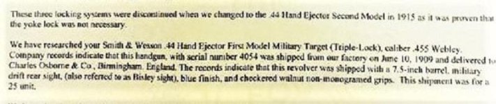

I revised the section on .455 Webley Target Models to serial numbers 4000 to 4300 from 4100 to 4300 and the number manufactured to 100 based on this shipment alone of 25, and there likely was more than just one shipment.
