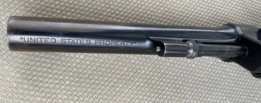

Dear Forum Members, today is a good day, I woke up and as usual I checked the new and used firearms sell and trade website market, I found and purchased this beauty for 1900 Euros (about $2000), rare here in Italy in this condition, I would be happy to have your authoritative opinions.

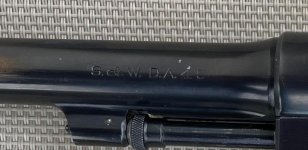

pics of the marks and serial number
Please explain me the meaning of the marks
The first picture is the U.S. Army Ordnance symbol, usually referred to as the "Flaming Bomb". It is actually a hand grenade. The S7 and eagle are the army acceptance mark. Of course the number on the barrel flat is the serial number of the gun. Assuming it is original that is the nicest looking 1917 S&W I have ever seen. The only thing is the stocks have been re-finished, or simply an additional coat of a drying oil type finish added at some time.:):):)
I believe that revolver was accepted by the Army in August 1918.

The eagle over the S9 is just the head with beak pointing up.
The concave or “dished” tops of the grips ended approximately between serial number 15,000 to 20,000. Does the penciled serial number on the back of the right grip match the gun number?
