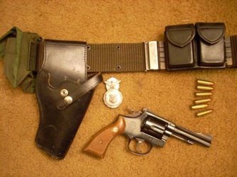

The slide trick was an LA thing and a bit of a fad. Why take the slide when you can take the whole gun? LA Police dealt with a lot of nonsense over the years. When they had the K38's in the clam shell holsters ; kids learned where the release button was and would push it and let the gun fall on the ground.
That one is absolutely true. If you pull the trigger hard enough, you'll break the lockwork (most likely the hand) in your revolver before you overcome the friction of even a relatively light grip wrapped around the cylinder. Same if you tried to pull the trigger inside a well-fitting leather holster that grips the outside of the cylinder. Small parts will break before the cylinder rotates.

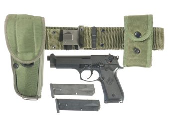

As far as people bad mouthing the Beretta M9 I have always liked the pistol if you know its limitations. I once saw a custom M9 with a screw in barrel bushing. It was done for maximum accuracy in competition. Do you really need that kind of accuracy in a defense gun? I do not think so. My Italian and American Beretta's give me all the accuracy I need.
It is true some Military M9's blew up because of a steady diet of Military Plus P Plus loads. Beretta later put a "hump" in the slide rails and put in an oversize hammer pin to deflect any sharpnel if the slide blew up from too many hot loads. The average guy would never put that many loads through his gun, especially the super expensive Plus P Plus loads.
The Beretta M9 was developed off of the Walther P38 locking system which had the same problem of cracked slides as the slide is very thin like the Beretta's. I once had an oddball French P38 (P1)) police post war aluminum frame gun that had the slide rails built up at the factory. Whether this was a factory experimental or a permanent modification I was never able to find out. I wish now I had never sold it because of its rarity.
Both of my Beretta 9x19 guns have been extremely reliable and the extra sighting radius is an advantage when shooting it. Trigger pulls are decent. Sights are visible.
