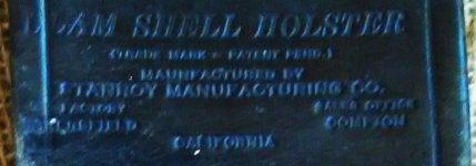

There are Stanroy versions of the Speed Holster, that being the family name of Jewett's ex-wife. They feature the wire loop for the trigger blocking device as do the Northey versions; but not the Hoffman or Safety Speed versions. Stanroy also does not appear in the Cal Secy of State database as a company.

I still confused though. Since my granddad's holster has the wire trigger guard and no name stamped in or on it, it was obviously made by....oh, who knows?!
I don't blame you! I think without the marking, and in that time frame, we would think of it as a Jewett, made by Northey under the four-way partnership but before the name was established as the Jewett Safety Holster Co. The partners all are mentioned in a 1936 article about two CHP officers being en route to a police pistol competition in Mexico City (which is called Distrito Federal and so 'D.F.' and pronounced 'day effay' in Mexico vs. Ciudad Mexico, the literal translation) with their clamshells. But by '40 as mentioned the partnership had been dissolved and perhaps that is when the formal name was adopted.
And the info about the partnership, was always emblazoned across the top of Jewett's patent: 1/4 interest to the inventor and to the three partners, who are named there.
