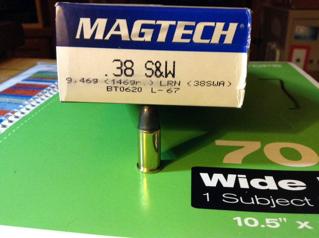

Have not tried that brand but it appears to be a typical factory loading. In the USA the 38-200 is known as the 38 Smith and Wesson or 38 Smith and Wesson Short. Both Magtech and Fiocchi as well as Remington still load this caliber. I would shop around for the best price if you don't do reloading yourself.
Example:
.38 S&W Ammo - .38 S&W Bullets | Cheaper Than Dirt
The .38/200 is simply an obsolete moniker for a caliber that started in the blackpowder era and has been called all kinds of things.
These are all dimensionally identical and will chamber in anything from a rattly little 1880s topbreak to a Victory BSR overbuilt for any load in this caliber.
So be sure of the pressures and if in doubt don't. The big guns, Webley Mk IV, Enfield No. 2, M&P, and Colt OP can handle every load, but caution is necessary with smaller guns. Some surplus European military .38/200 loads have been reported at up to 50% higher pressures than standard .38 S&W.
I just ordered a box to try in my BSR. I also ordered 4 boxes of the trapdoor Springfield loads. Thanks the tip on their website.
