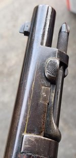

I just picked this one up.
It appears to have the experimental ram rod.
I know so much about these the receiver being case colored threw me off....lol

Nice rifle. I missed getting one years ago. Still kicking myself.
Your rod bayonet looks like the standard Model 1888. The experimental rod bayonet was the triangular one from about 1880. Pictured below is the standard rod bayonet (top) and the triangular one (bottom).
The 1888 models didn’t see much action, so it’s not uncommon to find them in great condition.
Thanks definitely see the difference
How common is the round rod bayonet like mine.
Any other information you have on mine ?
The serial is 511252 so probably 1891 ?

There were several experimental attempts during this time period with the trapdoor rifle and the bayonets. This experimentation continued with the Krag rifles and bayonets at the turn of the century.
If you're going to collect these rifles, Flayderman's Guide is a good general source of information for early American firearms.
Model 1880 experimental with triangular ramrod-bayonet was serial numbered in the 154,000 to 158,000 range. A total of 1001 made. Inspector cartouche on these is 1881.
I've got one buried away some where.
Model 1884 experimental was a round ramrod bayonet with a fixed front sight cover. Total production of 1000 around serial number 320000 with cartouche 1885 or 1886.
Model 1888 standard issue (OP's) were made from 1889-1893. Total quantity around 65,000. Serial numbered in the 500000 to 565000 range. Thus the 1891 cartouche on the OP's rifle.

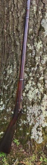

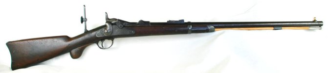

Here's my "scarce" TD. It came off of a ranch in NE Washington and looks like it had a tough life. The guy I got it from remembers in the 1930's having this as something the kids played Cowboys and and Indians with.
It is a legit M1875, just worn out with a few replacement parts. (Wiping rod, Tang sight, Hammer screw)
You probably already know this, you have what appears to be a desirable "Officer's Model Trapdoor." Even with the replacement parts, it is valuable as not many were made. Looks to me in reasonable condition.
I've pretty well confirmed it is an original, but I can't find any comparables as to how to value it. The only ones being offered or sold are minty and this one surely isn't...:(
(BTW: Production of the Model 1875 was around 485 or so..)
The museum where I volunteer has one in the collection with fairly solid provenance that it belonged to Major Thomas T. Thornburgh. He was killed at the Milk Creek fight in Colorado in September 1879. On the same day, Utes killed agent Nathan Meeker and 10 of his while employees at the White River Agency.
Ours has been modified, but still quite valuable because of its history. I can't help with the value of yours.
I have found that just who owned an OM difficult, if not impossible, to connect to a specific rifle.
I have a complete list from Springfield of the purchasers of these rifles, but the rifles are not serialized, so without family or unit history, the chain is broken.
My rifle came from near Fort Colville, so maybe someone stationed there? The ranch was settled by a pair of Swiss immigrants who could have picked it up anywhere on their travels West. (AFAIK, the decedents still own the ranch.)
