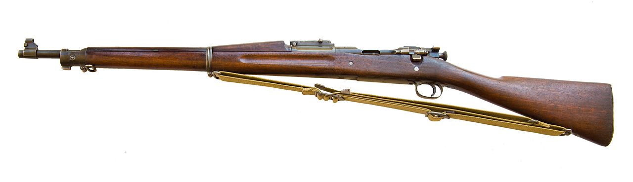

There is a wide spectrum of Mark I Springfields out there. It is true that most were converted to standard '03 configuration by substituting normal sears and cutoffs. The prized ones have all original parts designed to work with the Pedersen device, and today are worth considerably more than a standard '03. Here are some pictures of one that's correct.
This is a full length view. Note the ejection port cutout in the receiver. This one also has the very rare M1927 sling.

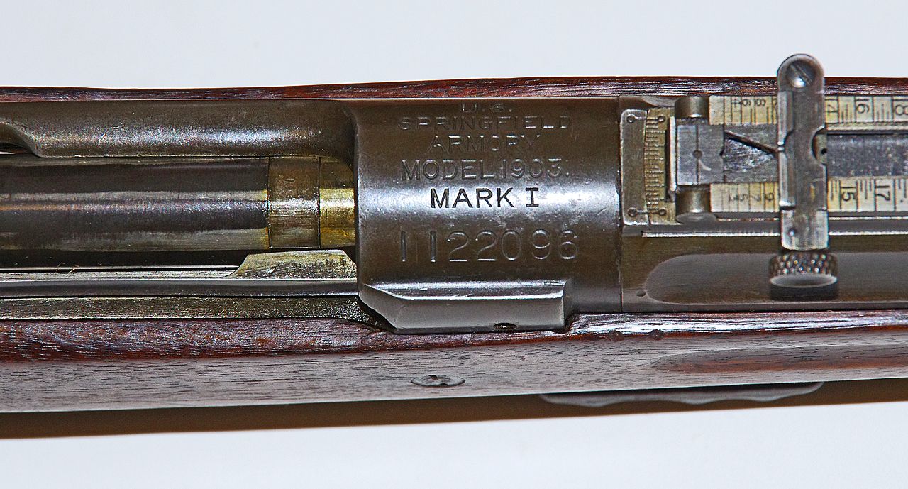

Here is the correct model marking on the receiver:

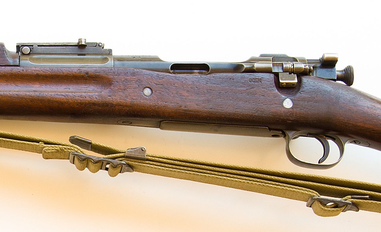

Here is a closer view of the ejection port:

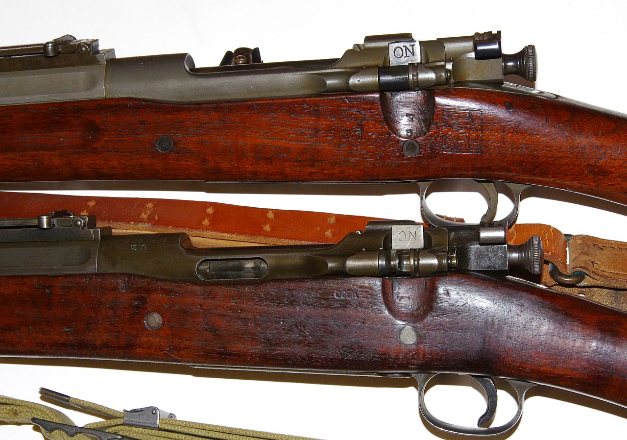

And finally, a comparison of the two types of cutoffs. The standard M1903 is on top, and the Mark I is underneath it. The cutoff must be flipped up to see the difference. Most of the Mark I cutoffs I've seen have sans-serif letters. Finally, the barrel and receiver group must be separated from the stock to verify the presence of the semiauto sear.
Hope this helps in identifying an all-correct Mark I '03.
