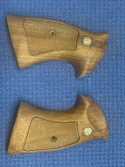

I have a pair of mid 1970's S&W football targets that I had to strip the finish (with acetone) due to some flaking of the factory finish. I know what they look like with a factory type finish on them, they are kinda light colored. Since they arent pristine and will need a refinish anyways, I was considering trying to stain them a darker color before putting a true oil on them. Has anyone tried this or had luck changing the color of your stocks? Back in day I did a lot of stock refinishing on M14 stock and other mil surps rifles. I bleached many and did different cherry and walnut color staines on several. Any suggestions on getting a darker brown walnut look to a set of factory GA N frame stocks?
Here’s what they look like now

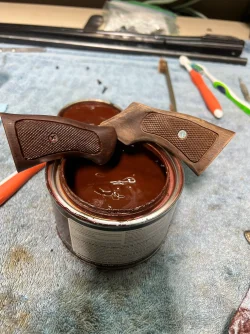

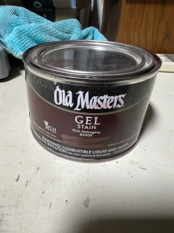

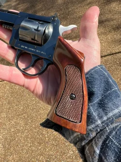

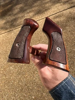

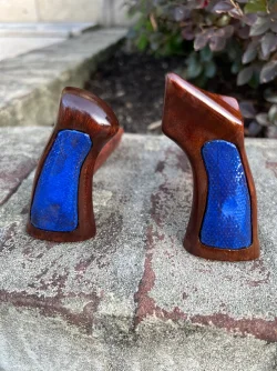

I have used this gel based stain with success when I want a darker reddish-brown color. I did a long post on repairing and refinishing a set of K frame Targets a year or two ago:
Target grips repair and refinish

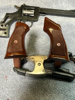

I used this stain in December on a set of grips for my friend's old H&R .22 revolver.

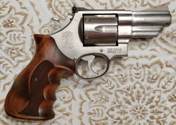

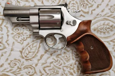

Both of these examples were finished with Tru-Oil. Several hand applied coats then several coats sprayed on with a small $15 sprayer from Harbor Freight (tru-oil cut 50/50 with mineral spirits to spray). I then use some stock sheen and conditioner to knock the gloss down a more satin finish from a piano gloss.
