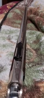

I got the marlin barrel and turned it down to make a line for my Crackshot. Got it epoxied in the other day. Did the muzzle, reamed the chamber and did the cut for extractor this morning while it was raining. Sun came out and went to the range with it. A few taps on the rear sight had it centered, But a bit low, I did not bring a file, so waited till I got home to take some swipes off the top of front sight.
