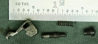

1. Is the screw pictured a later 'flat base' ?
If so, I can look for on more appropriate to this '42 Victory.
2. Should the stop, or stop and plunger be replaced?
See photos.
The plunger looks OK to me, but the stop's slot seems oddly worn or filed.
The stop was slow in releasing from the trigger in double action. I polished the nose a little but was thinking it could be the spring and or stop also contributing. ??

Looks like it. The threads were turned off the earlier screw and that section pushed down inside the spring. You can see that the top of the spring is deformed, likely by catching the bottom of the screw as it was tightened. I think a new spring and care when replacing the screw will allow the stop to work correctly.
Thank you.
I see there are a couple different types of springs for sale. One with open ends (like the one out of this gun) and another with with more coils and closed ends. Closed ends probably less likely to get caught in the threads.
Figured out the stop's head was hanging up on the left side of the window.

Here's a photo replacement spring (new) which measures the same as the old spring other than free length. While I didn't use it right away, I did install it after fitting another stop.
The replacement screw I bought is the same style, so it will just go in the spare parts stash.
