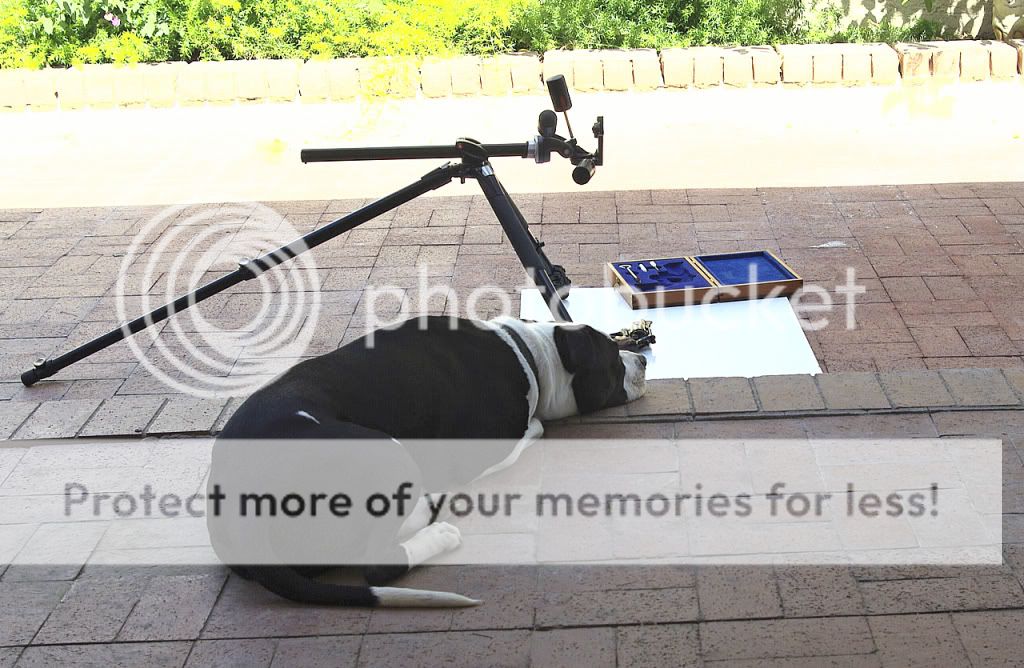

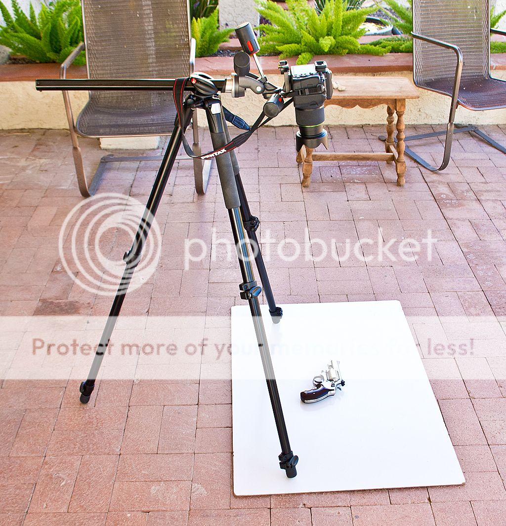

Here's my typical outdoor shade setup. Dogs are optional. My old dog Joe was always there to give me support...

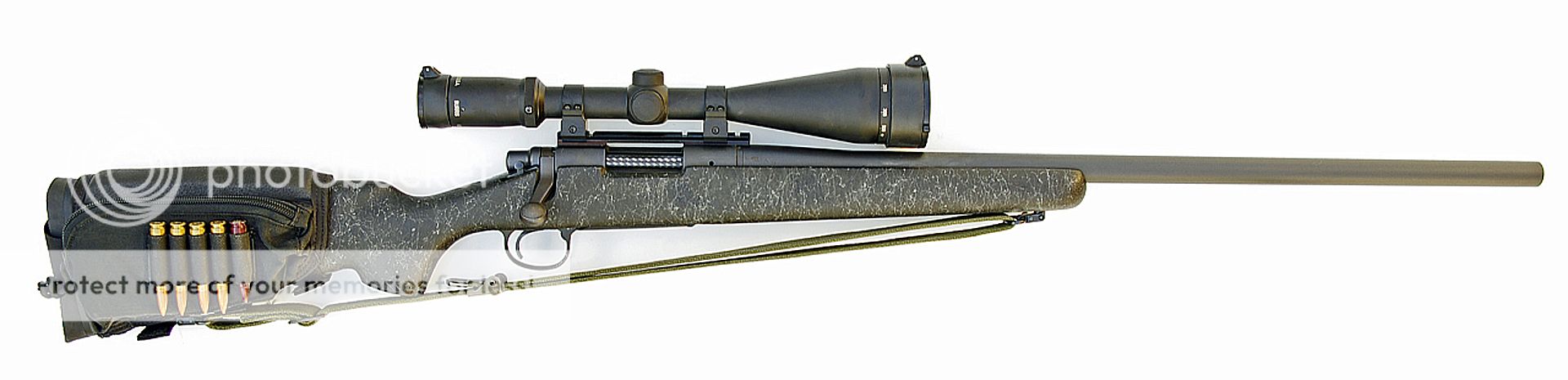

Here are samples. Click 'em for larger image.
