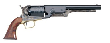

I also have some FFG Black Powder. I have loaded 50gr for a Colt Walker pistol. 40gr is the usual load I use. It was made to kill a mounted man or take out his horse. Effective at 100yds. It was the most powerful production handgun from 1847 to 1935 when the .357 mag came out.
I like the smell and smoke of BP!
