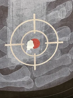

So I have loaded both 45 Colt and 357 with TCM. Still haven't taken the 45 out yet. The 357 on the other hand, WOW. Lovin it. I did this at 7 yards standing with 2 hand grip. 5 rounds.
Recoil is manageable. Gun and ammo did all the work, I am just the jerk behind the trigger as they say. This was with 12 gr TCM pushing a 158gr Hornady XTP. Going to have to experiment a little more but, already happy with what I have.
