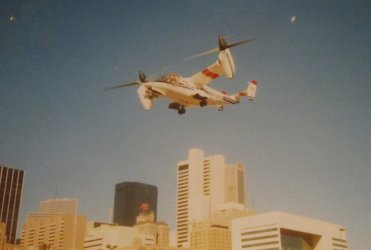

Here is a picture of the XV-15, prototype to the V-22. I took the picture at the Dallas Convention Center, mid-1990's. They were built right down the road in Arlington.

More of a proof of concept than prototype.
If the latest Bell design eliminates that cursed clutch in the Osprey design, then I'll give it a cautious maybe. I'd have put my money on the Sikorsky SB-1 Defiant design so as not to have all my eggs in the tiltrotor basket.
View attachment 762746View attachment 762748
