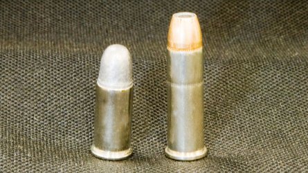

The BULLET diameters are not what is significant when comparing these cartridges. The CASE O.D. (and less importantly, length) is the physical difference.
The .38 S&W case has larger O.D. than the Colt Short, Long, Spcl, .and 357Mag cases. The .38 S&W uses a similar sized O.D. bullet because the .38 S&W uses a "heeled" bullet…The bullet diameter is smaller where it enters the case-mouth (similarly to the .22rimfires s/l/l.r. versus the .22 mag).
For this reason, .38 Short Colt, .38 Long Colt, .38 Spcl, can all be shot in a .357 revolver. But the .38 S&W, having a larger O.D. case, will not fit into a .357 (or .38 Spcl) chamber.
Hope that helps.
Here's also a pic of a .38S&W vs .38Spcl … it should be obvious the S&W case is larger O.D. than the .38 Spcl (and therefore .38 Colts)

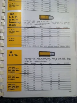

A couple of small nits to pick............ First, my Lyman reloading manuals state to size cast bullets to .360 diameter not .358. None of my Lyman books show any data for jacketed bullets in the 38 S&W/38 Colt NP so I don't know which book you are using for that data. A .358 bullet can be used but may be undersized in many guns of that caliber. Hornady may recommend a .358 as that size is more widely available and will work even if it's not the ideal size. As an additional check I measured some 38 S&W factory bullets I have and they were .360 diameter.
Second thing is the 38 S&W does not use a "heeled" bullet. A 'heeled bullet has it's lubrication grooves on the exposed portion of the bullet outside the case (as in 22LR) and not on the part of the bullet inside the case mouth. The 38 short Colt does use a "heeled" bullet as did earlier version of the 38 Long Colt before they switched to a hollow base bullet to get the lube grooves inside the case. The 38 S&W has been an inside lubed design from the start.

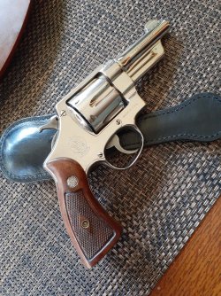

I've owned a few over the years, mainly pre war, particularly during my "gangster gun " phase of collecting.
I'm down to one, a 1946 "Transitional" refinished in nickel (nicely refinished I will add). This is a superbly accurate six gun that is fond of Buffalo Bore's "Outdoorsman" load, as it supposedly duplicates the original 38/44 loading. It's a mildly stout load, but nothing that the N frame doesn't soak right up.
