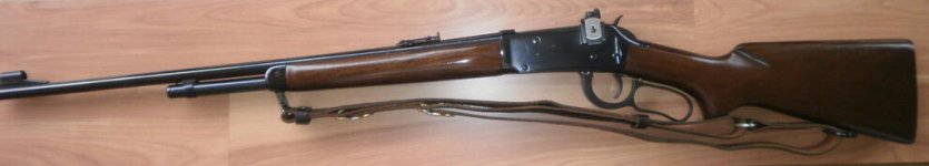

I bought my Winchester 64A (the plain version – Not the NRA commerative) in 1972 or possibly early 1973 at the nearby Woolworths where a friend of mine worked in Sporting Goods. He let me pick the better of the two Model 64As that had come in. The rifle came from the factory with an inch-and-a-quarter M1907 style sling but 1 inch (?) QD swivels; the forend tip has a hole for the front swivel machined into it. This rifle has a machined lifter rather than the miserable-looking stamped lifter that had been introduced with the 1964 redesign. Perhaps it’s an optical illusion but it looks to me like the Model 64As have less drop in the comb and a less cramped lever loop than the original Model 64s. Regardless of the changes, it is an elegant-looking lever gun and probably the last one I’d get rid of.
I agree that there are some subtle differences in the lever and the stock between the 1936 and 1972 Model 64s. I reversed the shot of my gun to give the same orientation, and have compared it here to yours. This may give a clearer idea of the changes.
