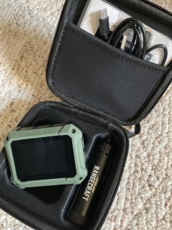

I bought the Athlon Rangecraft Chronograph
$400 at the great Scheels sports store.
It's compact, easy to use, turn on, point
towards target, and get your velocities.
I like it.
A friend and I tried it out on Bow/Arrow
speeds. He said the Athlon Rangecraft
processed the velocities faster than the
competitions pocket chronograph.
To set up the App on your cell phone watch
the Athlon video.
I would say these new miniature chrono-
graphs annihilated old conventions.
Handier than a pocket on a T-shirt.

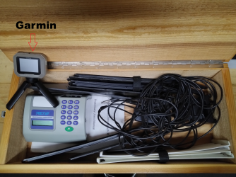

I recently bought a Garmin and this technology appears to be foolproof. Just compare it to my PACT Professional XP. Of course you have to add a tripod as an extra since it does not fit in the case I made to get all the other stuff in one box. The key is that I can throw the Garmin in the shooting bag every time I go shooting - and do! It fits in an old zip up electric shaver case.

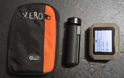

I've had a Garmin XERO since they came out. It travels with me to the range everytime (why not? They are tiny.)
As far as a case, I had an old LowePro Newport 30 case sitting around for a digital camera I don't have anymore. It fits perfectly. Added bonus is that the case has one side that is stiffer internally and that is the side I place the LCD screen against for protection.
The Newport case is still available on-line.
