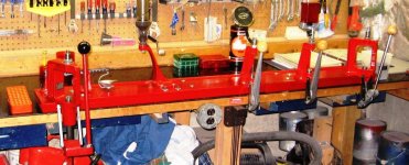

First of all, I don't like a progressive. Too many turrets to buy. Also, for any one caliber I use several different bullet types, so I have to adjust every time. I have 2 of their cheap "Reloader Presses" (paid something like 25 bucks each), so I can prime, flare, powder and bullet seat without changing presses. A poor man's progressive.....LOL.
The second thing I don't like is the auto drum. I use the pro auto disc with micrometer adjustment.
Thirdly, I use one of the old style press mounted safety primers. They are not available now, but I would buy a used one rather than using the current stuff.
Lastly, I hate the breech lock presses. Another thing to have to buy extra parts every time you get new dies. I drilled and pinned the breech fitting in place and JB welded it. Now when I change dies I simply screw them it.
I have always been proactive to crises and issues, and thus have bought supplies ahead of time. I am currently loading 38 spl and .45 Colt for a nickle apiece. Of course that's with home cast lead bullets that basically are free.
