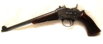

Besides the Olympic Chambered single shots done by Smith & Wesson, Harry Pope & A O Niedner did them on single shot pistols also. I have owned a fantastic Stevens Lord single shot & still own a Remington 1901 single shot with 22lr Olympic Chamber's done by Niedner Rifle Corp.
It has been my not so good fortune to have never seen neither a Pope nor a Niedner conversion available for sale in the mere 67 years I've been fooling with these things.(!!)
