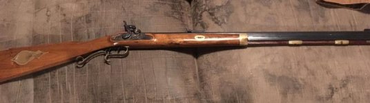

My kiddo got me this musket and I’d like to know how old it is. Does anybody know if there’s a way to tell? 142241 serial number

It's a nice gun, the age doesn't matter.

I bought my TC 50 Hawken in early 1978, serial # 163XXX. We got 3 in with serial numbers pretty close. Assuming TC went with consecutive numbers yours would be earlier than 1978.
4 digit very early 70's
500,000 mid 90's
You can kind of place yr w/ser# by sorting thru others info provided here.
Supposedly any records were destroyed in a fire, or that's the word anyway.
Guns w/a 'K' prefix to the ser# started out as kit assembly guns.
Bbl's are easily interchanged with the hooked breech. Aftermarket and bbl's from other TC guns have ended up on other than their original chassis.
The original intent of the hooked breech and wedge disassembly was for ease of cleaning as pointed out.
With that it had to be handled very carefully as the stocks of the original era were very fragile with the bbl removed. Very thin bbl inlet side walls. These modern repro stocks are built to a much more robust style.
Sharon Rifle Bbl Co made the first bbls for TC for their Hawken.
Those are marked on the bottom of the bbl betw the breech and the wedge loop w/a 'Spade' or Double Spade stamp
These will be generally seen up into the 4 digit ser#'s.
But TC didn't follow a lot of protocol when marking their guns. So called early features inclu bbl address or even lack of it, can be found on much later guns. Seems what ever marking stamp or parts were available went on.

They used Douglas bbls after they stopped using Sharon bbls. I don't know if the Douglas are identifiable or not or for how long they used them. TC eventually started making their own bbls.
Thanks to everyone for all the great information. I was guessing it was mid to late 70s. Very informative. I’ll have to get a 50 cal mold to cast some round balls. I think I have everything else. It’s a pretty nice rifle. My other muzzle loaders aren’t quite as nice as this one.
