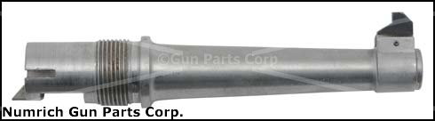

Ruger Standard Model Semi Auto pistol bbls are threaded into the receivers,,and extremely tight.
With proper bbl vise and recv'r wrench, you can get them to unwind though.
If you are scraping the present bbl, lathe turn or even hacksaw a ring around the bbl as close to the frame/receiver as possible w/o actually touching the frame.
That releases the pressure of the draw up on the threads when it was installed and will come off very easily.
The replacement will still need a bbl vise and wrench for installation though to do it correctly.

If you are indeed looking for a new barrel--better find out if they are to be found at all. To the best of my knowledge Ruger never sold them as a separate part.

Ruger barrels are screwed in very tight, but can be removed as stated above with good barrel blocks and wrench. I have a 4 3/4" bbl and 3, 6" barrels for sale. 45.00 ea plus 6.00 shipping. They are all very good shape and were removed from MK 1's when I made bull barrels for them back in the 80's
